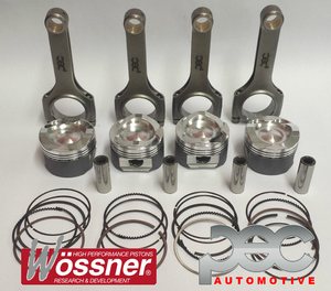

Piston, Kol takimi [TAMAM]
http://www.steelconrods.co.uk/product_info.php?cPath=22_34_126&products_id=1406

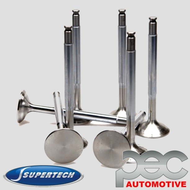

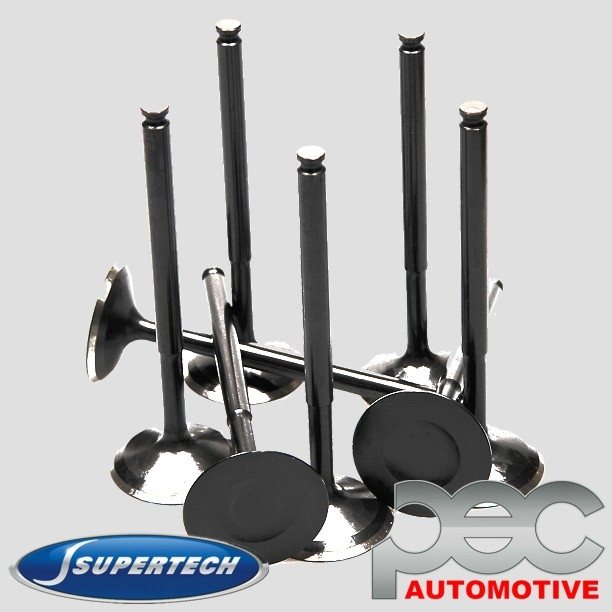

Egsoz Valfleri [TAMAM]
http://www.steelconrods.co.uk/product_info.php?cPath=77_79_192&products_id=1448

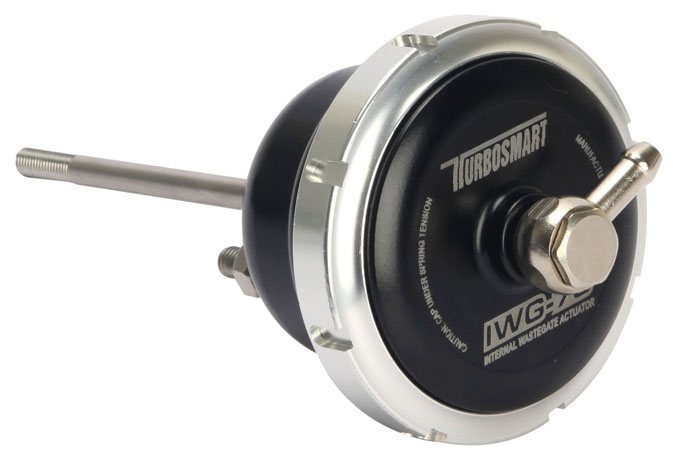

Turbo Wastegate [TAMAM]
TurboSmart Wastegate

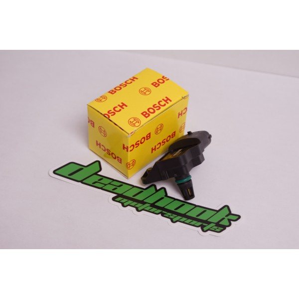

Maf & Map sensorleri
http://deadhookmotorsports.com/Fiesta-ST/Fiesta-ST-Fuel-System/Boush-35bar-TMap-Sensor

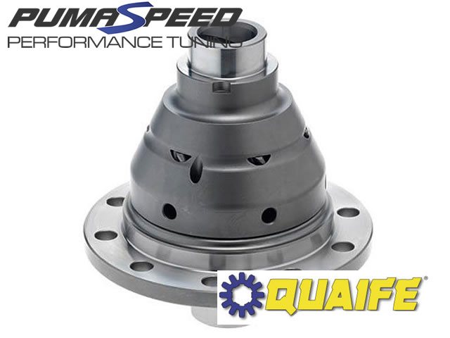

Difransiyel [TAMAM]
http://pumaspeed.co.uk/product-Ford-Fiesta-ST-180-EcoBoost-Quaife-LS-Differential_16207.jsp
http://www.pumaspeed.co.uk/product-Wavetrac-differential-for-Fiesta-ST180_16810.jsp

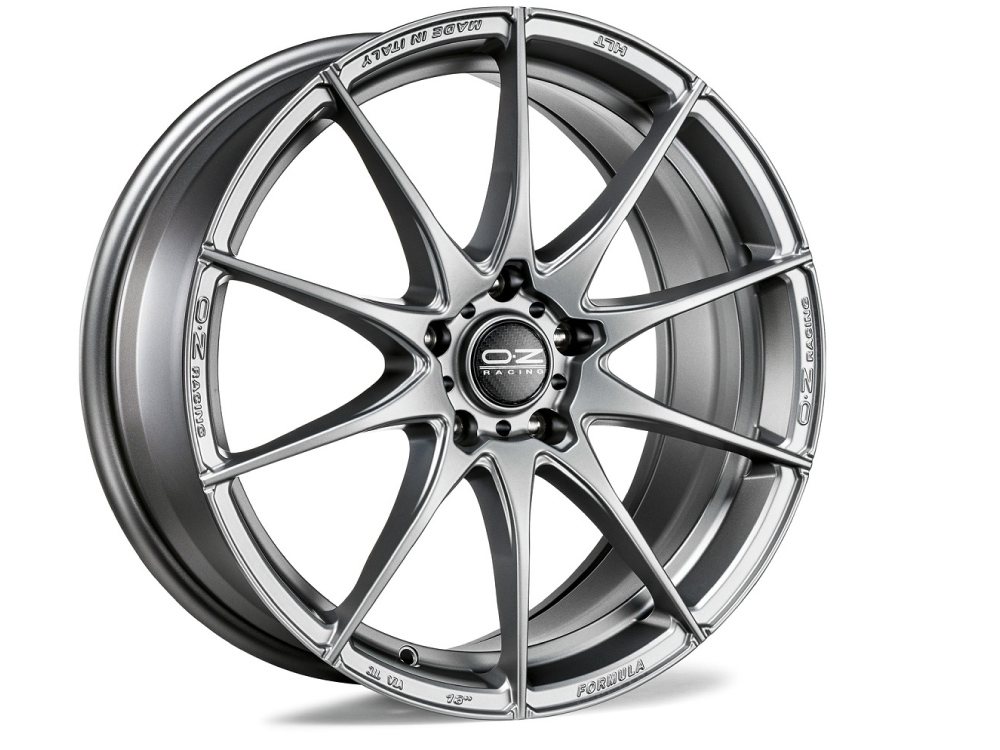

Jantlar [TAMAM]
http://www.ozracing.com/wheels/oz-racing/i-tech/formula-hlt-5h
Oem 18" Lansman janti takilacak.

Sen stage2 kafasi gideceksen siddetle turbo wastegate'ini ve dump valve'ini degistir. Duacim olursun.
http://www.turbosmartdirect.com/Product-Categories/Model-Specific-Actuators/IWG75-Ford-Fiesta-ST-1-6L-Ecoboost-Black-7PSI.html
http://www.turbosmartdirect.com/Product-Categories/Kompact-Series/Ford-Fiesta-1-6L-EcoBoost-Kompact-Shortie-Plumb-Back.html
Yeme de yaninda yat modeli.
Stage 2 kafası aynen :) kafayı kırdım sanırım .. İridyum Buji,intercooler,70 mm downpipe , bobin kombini düşünmüştüm bütçem yetiyor bunlara şuan fakat bobin düşündürdü benide . Bobin olmadan dediklerinle ilerlenebilir mi ? Yapcam çünkü koydum kafaya :)) @Servet Özkan
